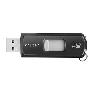

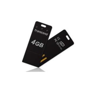

Posted on: 01 May 2010 by Thorsten_L
Very good, but deinstall the shitty software on it under U3-settings.
IMHO the best:

I have just got my Naim DAC and bought one each of these sticks. The Sandisk seems fine. The Transcend worked twice and now refuses to work, although it can be used in any of my PCs to play back 16-bit and Hi-Res audio files.

With the Cruzer stick I had to uninstall the pre-loaded U3 and then format in a Windows 7 environment (not directly from Disk Utility on Mac) to get it to work. Now working with a variety of .wav files including HD. Oddly, it seems to be OK to delete and add tracks / folders on the Mac once the stick has been formatted in PC world.
Using the remote to skip tracks is a boon, even if functionality not in the manual. Also, the Cruzer stick does not fit easily but I was able to resolve this with a USB extension lead which makes things easier all round.
