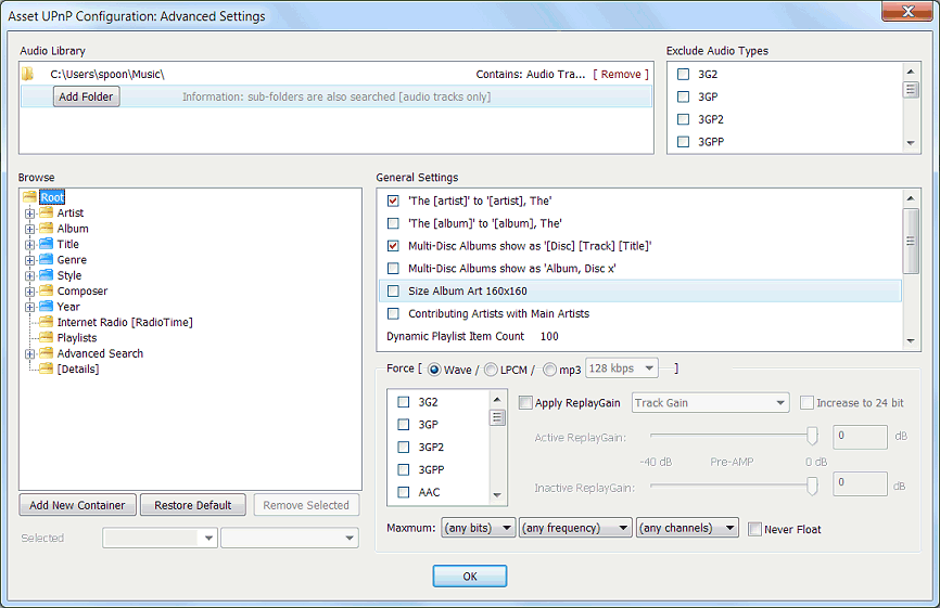

I have now installed Asset as my UPnP server and I want to use THIS now on my NDX and not Windows Media Player. Can anyone help? I have read the manual and I cannot figure out what to do on my NDX!!

I assume you have Asset running on the PC that you were using WMP on. You just need to open the Asset to bring up it's application window and configure it to point Asset at the music folder you have been using WMP with. Using the 'Edit' button in the Asset window will bring up the following window on your PC.
In the 'Audio Library' window at the top, to change the folder you want to scan, first click the [Remove] item ( top right of this window) then click the 'Add Folder' button which will bring up an explorer window of directories which you can navigate in to reach your Music folder. Once selected click the 'OK' button to exit this window then in the main Asset window, that you then return to, click the 'Rescan' button to scan your music folder. After a short while you should be able to go to 'Asset' on your control point app of choice and use it to pick music and tell the NDX to play it.
