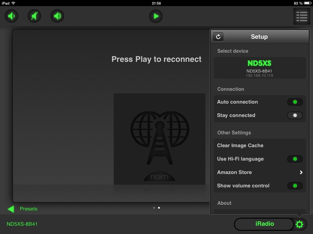

Hi,
Using an IPad mini, you should see this screen in 'settings' showing the ND5, which automatically seen by n-Stream. If not, I would trash the n-Stream and download another one And try again.
Sorry, that's all I can suggest as it was all automatic for me.
Jason.
p.s. I dont have 'Stay Connected" on as it drains the battery quicker, I prefer the second or two it takes to reconnect over a quickly drained battery.
NStream will work when your streamer is on a wired connection. Wired is the best way to use it. I would kill the app, or delete and reinstall it. It will search for streamers, and then you need to select the nd5, which should appear.
Well done, Jason, that's the screen. You need to select the streamer. Just to avoid confusion, it's nStream, not nServe that you need.
