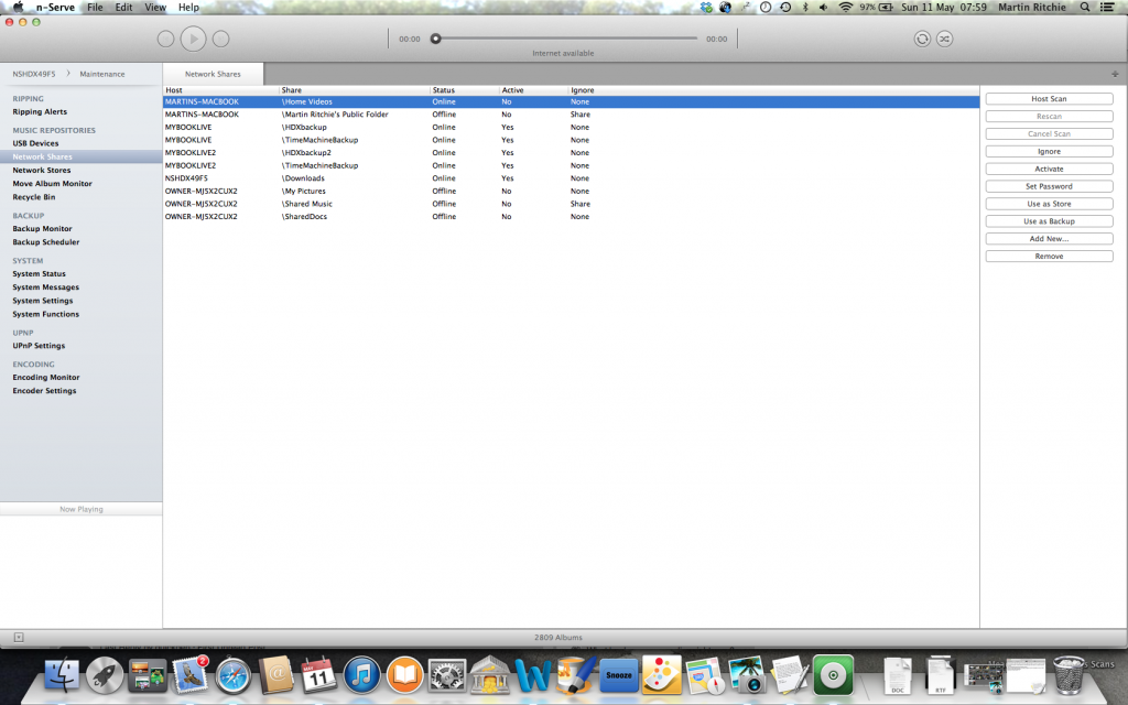

I have tried to set up a new back-up for my HDX.
On the set-up page for my NAS, I have created a share that I've called "HDXbackup" which is enabled and the n-serve app shows it as active.
There is nothing in the "HDXbackup" folder at all.
It's showing as enabled, online and active.
I clicked on the button "use as backup" which is now greyed out.
However, when I go to "back-up scheduler" or "back-up monitor" there are no drives or folders listed.
What am I doing wrong or what am I missing?
http://i204.photobucket.com/al...erve_zps33871805.png

Posted on: 11 May 2014 by hungryhalibut
Have you set the access for the backup to be available to both admin and guest? I'd set up a new share, with all its name in lower case, no gaps, and then promote it to be a backup. It should then appear as a usable location for backups.
If that still doesn't work, call Naim and ask for help. Setting backups from the Naim servers does seem inordinately hard - getting my UnitiServe to backup to the Synology was a nightmare! But once it's sorted, you can set a daily or weekly differential backup and it all happens automatically. It's just that getting there is something of a challenge, as you have discovered.....

Posted on: 12 May 2014 by blythe
I have just managed to activate the share as a backup.
I "think" I deactivated the share, then chose "use as backup". But whatever I did, they have now appeared as backups. Only took me a few days to get it to work.......
