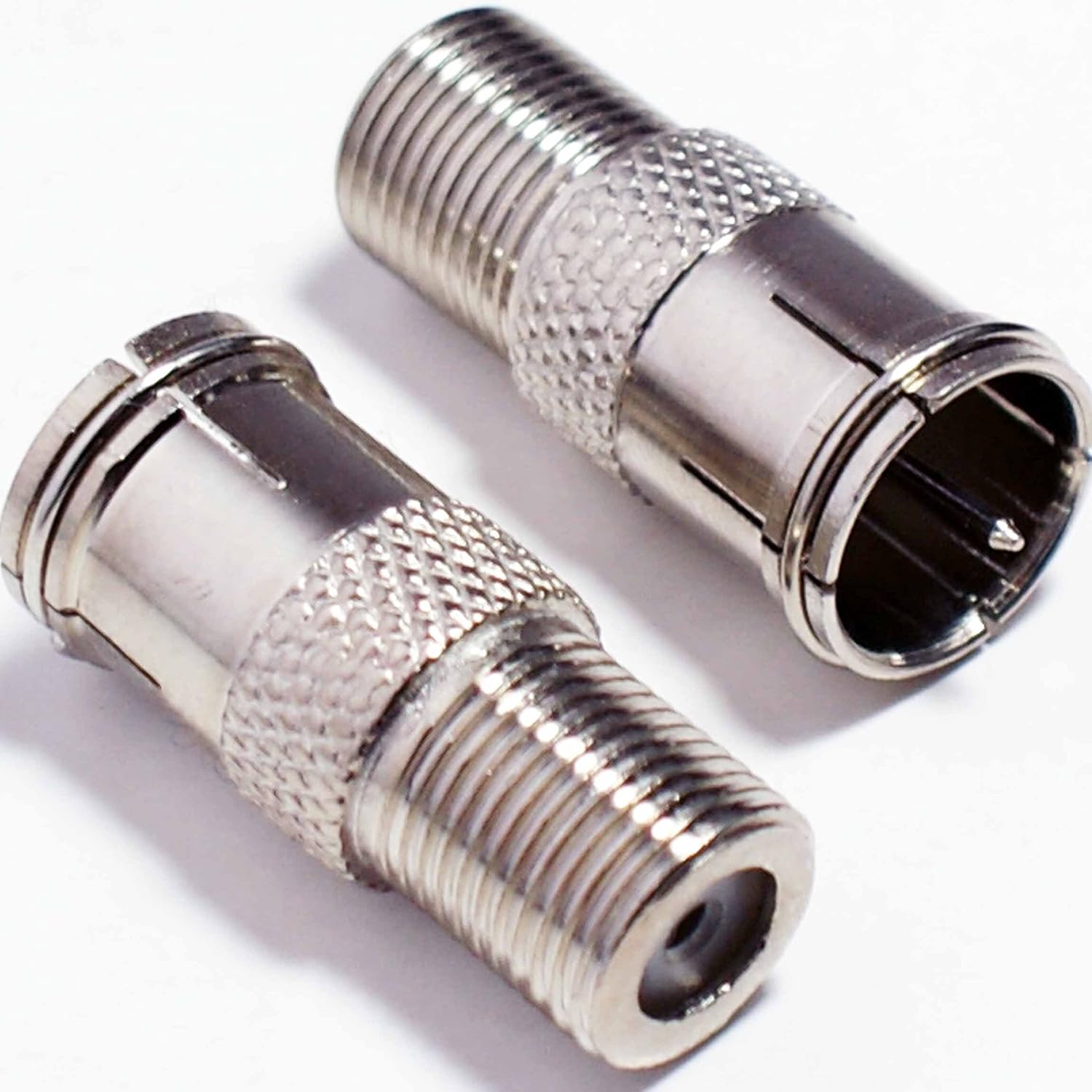

Posted on: 06 December 2014 by tonym
You'll find most aerial installers use one type of cable for satellite and terrestrial. It also makes pretty super digital audio interconnects!
Our Sky HD box gets moved around regularly between two homes so rather than having to fiddle with the screws, (a real nuisance when you've got arthritic fingers) I use push-on connectors at both locations, which work a treat.
