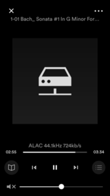

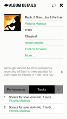

my artwork issue is like this....
while playing in the now playing screen it looks like this

but when I click on the book at the bottom left it has the artwork like so
http://i1342.photobucket.com/a...FD9E_zpsvhvvhtyu.png

just make sure your album art is called folder.jpg for some reason it needs to be this to be picked up.

I think I may have jumped teh gun on having succesfull artwok in one location in the app and not another...
On mature reflection, it would appear that the "Album Info" view in the second link
http://s1342.photobucket.com/u...zpsvhvvhtyu.png.html
Is unrelated to the artwork stored in the location which EyeConnect is streaming, it would appear to be sourced directly from teh internet by the UQ, as some of the artwork rendered here is copmpletely different to the versions I have, and some of the information retrieved is just plain vanilla wrong...!!
(e.g. Vivaldi's Stabat Mater in both track lsiting and folder structure, the UQ in album view thinks is the London Cast recording of Annie Get Your gun!!)

Seems unlikely the UQ is getting any info straight from the net, as it just presents what the server gives it. It could be that either the app or the server are getting the info.
Whether it helps in this instance or not, I've found that in a lot of cases, things like wrong artist displaying etc. have been fixed for me by clearing the app's cache(s). This has been especially useful for times when the wrong albums/tracks show up when viewing by album/artist.
Settings>other settings>clear image cache and settings>inputs>upnp>clear upnp cache. Worth a try anyway, only takes a sec.

yes, you're right of course...
By UQ I was referring to the playback chain including the App, as I'm certain I don't own Annie Get Your Gun!!!!
It makes more sense that the App is sourcing the info including reviews and credits (which is my favourite feature of the app so far...)
Posted on: 27 January 2015 by ChrisSU
The album artwork and info you're looking at is from the Rovi database that the app uses, so in this case, it is coming from the internet rather than your server. That explains why you sometimes see different artwork there, although it doesn't explain why you got 'Annie Get Your Gun!'
