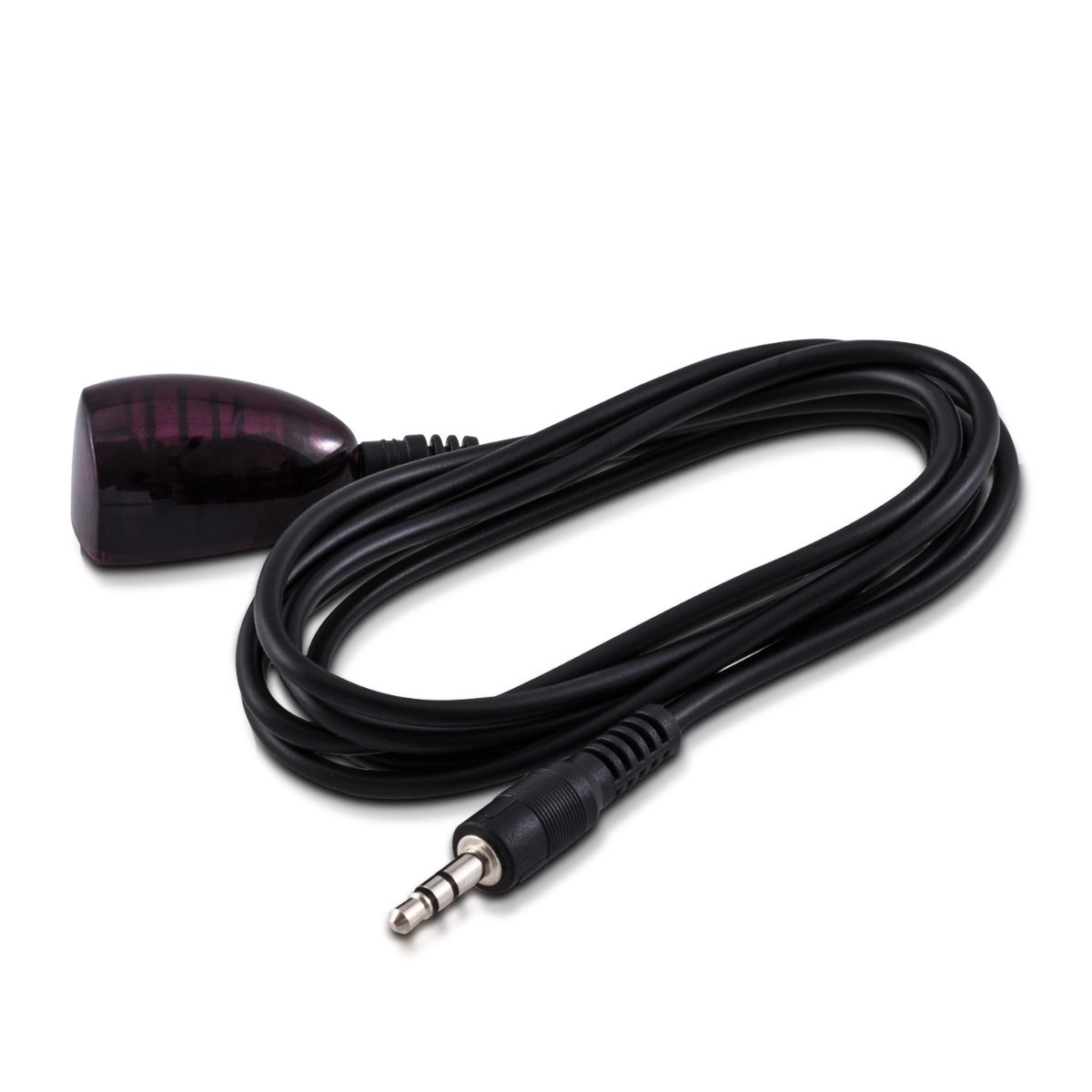

Anyone used a "IR receiver cable" like, for example, this:
IR receiver cabla
using that Naim "remote in" plug?

I finally got the IR-receiver from Amazon. I bught the kwmobile model shown in the picture. It does NOT WORK when plugged directly to the "remote in" SuperUniti plug :-(
I hope this help other users. I will go on searching more about it.

Javi, does it not support RC5?  Try to look for one that supports RC5. A Naim dealer who does custom install work should be able to advise you here.  Otherwise look for a repeater that sticks over the logo on the front of the unit.

The 3 contact IR emitters and receivers require a +5 or +12v supply (device dependant) as well as the TTL RC5 signal.
I also suspect that the RC5 out won't have sufficient current capability to drive a 2 contact device properly, but I haven't tested this.

The IR emmiter looks quite trivial as it look just like a IR led, but the 3rd pin on the receiver jack makes me guess that any kind of power supply is needed.

Output blaster ≠ input receiver + demodulator (if required by the destination device) + power supply. You need something that can juice up the IR receiver, and maybe clean it up by way of an inbuilt Schmitt trigger or the like (some receivers have this built in).

Just to confirm and close the circle - the IR receiver in the first image will not work as it requires power to function (its connections are power in, ground and signal out) . The RC5 inputs on our products are simply inputs (signal in and a ground) from an externally powered RC5 source such as a Xantech IR distribution block or the RC5 out of an ND product.
