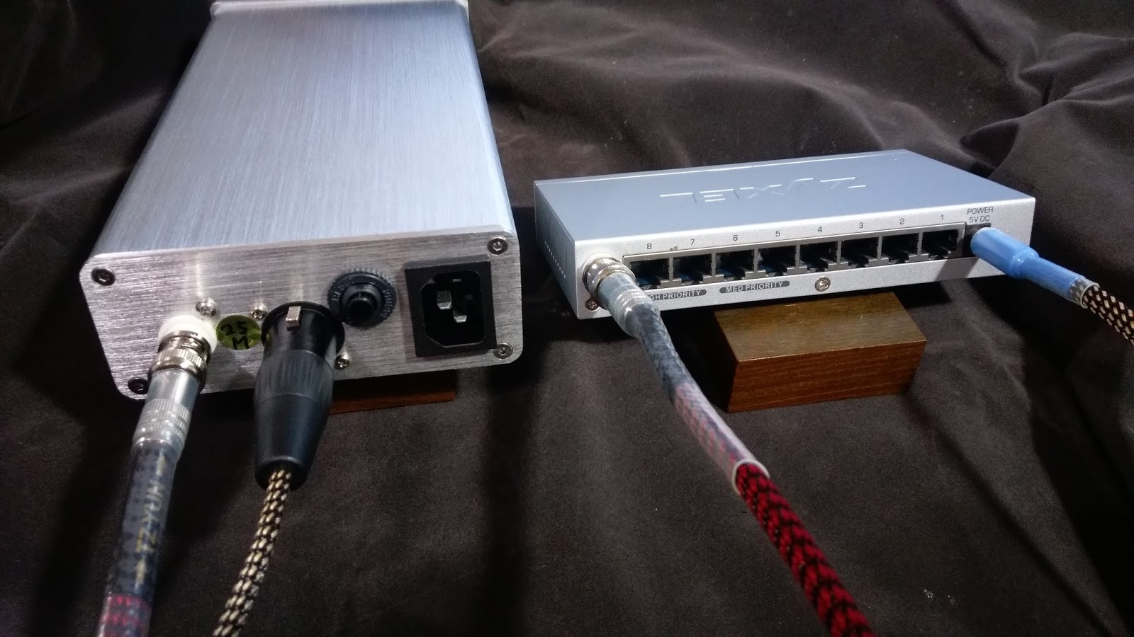

On Monday I fitted the Paul Pang ethernet switch into my high end streaming system, with linear power supply, and have to totally recommend this as a huge upgrade over the netgear 105. You won't get a better £100 upgrade.

Looks like you can go a bit too far with some of this Paul Pang stuff - externally clocked switch

The external clock just replaces the basic oscillator module that would normally be in the switch Adam - it's not a re-clocker. The picture i posted is a higher spec version of the Paul Pang switch. I was just a bit surprised as to how far some of these companies go...

I also note from the photo that Paul Pang device seems to offer three fixed flavours of 802.1p frame priority ports; High, Medium and Standard. I haven't seen this before on consumer stuff.. that is also interesting and will potentially allow more  consistent Ethernet frame timing performance irrespective of switch load...
This is one example of a  SQ improvement technique you can do with a commercial managed switch such as a Catalyst 2960.
