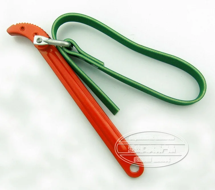

In my previous life I had products that used Burndy & similar locking ring connectors.  After a few years in oceanic atmosphere,  stuck rings were common.   We had a tool that used a fabric strap to grip the ring.  We made them ourselves,  but the principle was based on an oil filter can remover.  (see pic)     Obviously not a made to fit solution for you,  but maybe a screwdriver & a length of cord (shoelace or heavy string) wrapped around the locking ring could work.

Posted on: 14 September 2018 by Gazza
Mike-B posted:
Just ordered one of the river for less than a fiver

Posted on: 14 September 2018 by Mike-B
Gazza posted:
   ??   really,  can you get one small enough to fit a burndy ring ???
