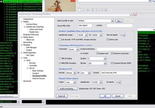

Posted on: 09 October 2011 by pcstockton
pls give us a screen shot of your Foobar UPNP settings.

Hi Patrick.......I hoped you might add your thoughts, thanks, screenshot attached, trust it is what you intended.
Thanks for clarifying the ASIO/KS issue, I could not see have to use these but could easily have been wrong.
Edit: Sorry for poor image quality, took ages to work out how to do it' if no good will try again.

Posted on: 09 October 2011 by Alamanka
I checked my Foobar configuration: same as in picture above except
- Samplerate range 44100 to 44100
- Max bit depth: 16 bits.
