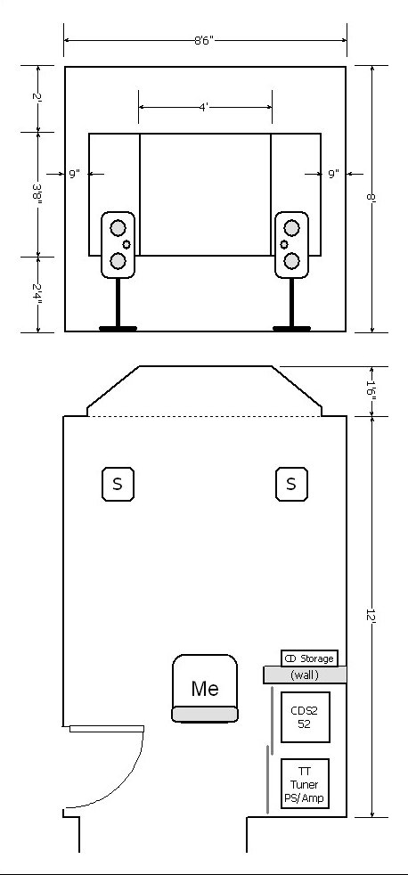

Posted on: 26 May 2003 by Mike Hanson
My room is also small, 8x12 feet, although I've got French doors behind my listening chair that lead to the dining room and then kitchen. Therefore, my speakers have room to develop those deep bass notes. My configuration looks like this:
Looking towards the speakers:
Looking back towards the chair:
