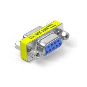

I've done my Superuniti ok (not tested yet) but, having newly bought a 'Qute, I now have my first problem in that it has RS232 port, not USB.
I have a Startech FTDI driven USB/RS232 converter which I've used previously to update my Meridian devices using a specific 'null modem' cable (whatever that is). However, my RS232 cable is female-female (adaptor is male and Meridian input is male) and I've just dragged out the 'Qute far anough to access the RS232 to find that it's female !
Therefore, if I want to use this adapter, I now have to get another RS232 cable with male at one end and female at the other it seems. Does anyone know if it will have to be one of these 'null modem' things, or must it definitely NOT be, or does it just not matter ? What a load of a**ing around !

Jobseeker - I had to get one of these for my original Uniti, seem to recall there is a link in the update instructions where you can purchase one for a few quid. (Includes all the drivers you need)
You need a gender bender. 95p off amazon
