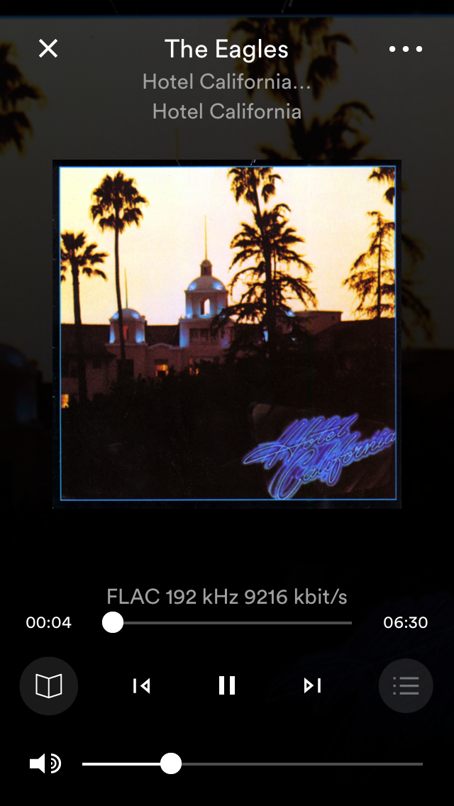

Hi PhilipH, got quite a few Albums from HighResAudio.com – never ever had any issues with their FLACs being MP3s. I would (like nudger wrote) suggest to check that no transcoding is activated on your UPNP server.
Hotel California from The Eagles is right on my playlist – please find a screenshot from the Naim app for reference what it looks like when I play that FLAC thru QNAP-HS210/Twonky/NAC-N172XS
