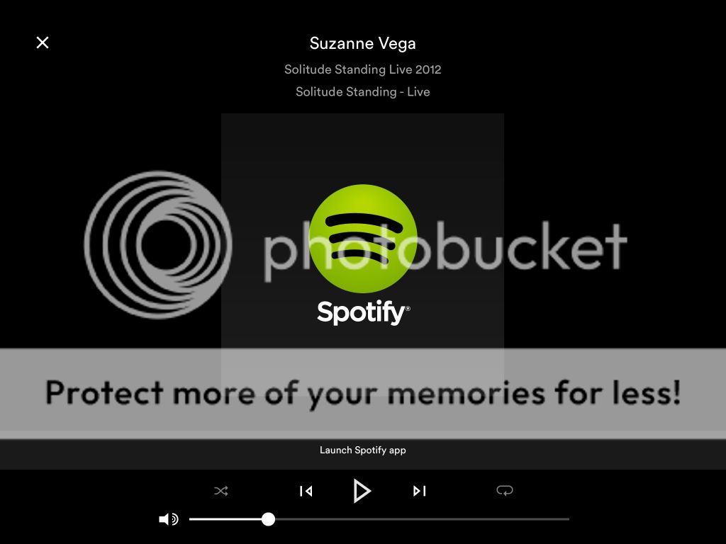

Close the spotify app by swiping it off the screen. Then go into the naim app, select the Spotify input and near the bottom you will see 'launch Spotify app'. Hit that and it will take you to Spotify. Set something playing, press the little speaker in the bottom right hand corner and see if the name of your naim box pops up. Should work.

Look - there it is, near the bottom.....
