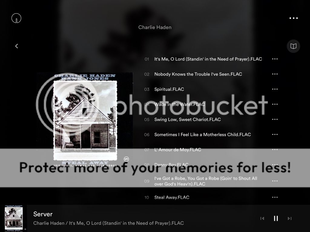

Posted on: 25 February 2015 by hungryhalibut

Ahha,  I see.  Are you transcoding ???
Posted on: 25 February 2015 by pixies
Hi Mike-B. Yes I am transcoding flac files to WAV. Do think this is the issue?

Posted on: 26 February 2015 by hungryhalibut
In my screen shot above, the track in the bottom bar is actually playing. The server is transcoding from FLAC to WAV, and even when playing in WAV it has the FLAC extension.
I thought it might be something to do witht he fact that the albums were UnitiServe rips, but my downloads and dB Poweramp rips are all the same, albeit say flac instead of FLAC. Any help would, needless to say, be much appreciated. If I can't get rid of them I may try Minimserver.

Hmmm. I use Media Server too, but don't get that. In Media Server>Browsing Settings I have "Music display format" set to Track - Title/Artist - Album and the track element is just that.
if you go to File Station and right click on a track, then click Edit music information, what does it say in the Title field? It should just be the track name not track name.extension.

HI HH,   I have just copied a track (Eagles "Get Over It") into a test folder.
I've converted that to .flac (default 5 compression) & .flac (uncompressed)
Without transcoding box(s) checked (ticked) on Synology DSM,  all three tracks show the same & have no file extension displaying
I then checked the DSM transcode box,  now I see one track (the .wav) with no file extension,  but the other two tracks (.flac 5 & .flac UC)  both show the file extensions - lower case .flac

I have the Music Display Format set to Track (only) & I get just that,  but with transcoding a .flac file,  it shows .flac - but shows nothing with a .wav file

Well I removed the transcoding option within music server and the file extensions have gone (all my music is originally ripped as flac via dbpoweamp). So its as Mike-B says above, it showing what original format is being transcoded I guess?
That just be right - I have a few WAV albums and they don't have an extension. Thanks.
