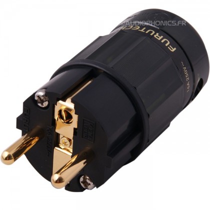

Ian, regardless of the country of destination/sale the mains lead would/should be earthed.  The European Schucko plug has the earth contact either around the circumference or within the hole for the captive third pin on the socket.

Mike, yes, it can be a problem. Not just in Italy either..  However, any Naim kit would have been supplied to Italy with a three core mains lead with a schucko plug to enable proper earthing of the equipment.

Its even more complicated Richard,  & even 'Shuko' is misleading.  Schuko is the German trademark thats been adopted for the German F type (CEE 7/3 socket & CEE 7/4 plug)    This stnd has a 2 pin (no 3rd pin) configuration with 2 earth connection located on the outer diameter of the plug/socket interface.    The other stnd is the French E type & although the L&N pins are the same spacing & diameter as the F type,  they are not compatible with the F type as the E type has an earth pin on the wall socket & a socket on the plug.    To overcome this the CEE 7/7 plug was developed to combine F & E types with both the outer diameter & the pin/socket earth connections.    These have adopted the Schuko name in the audio world.
