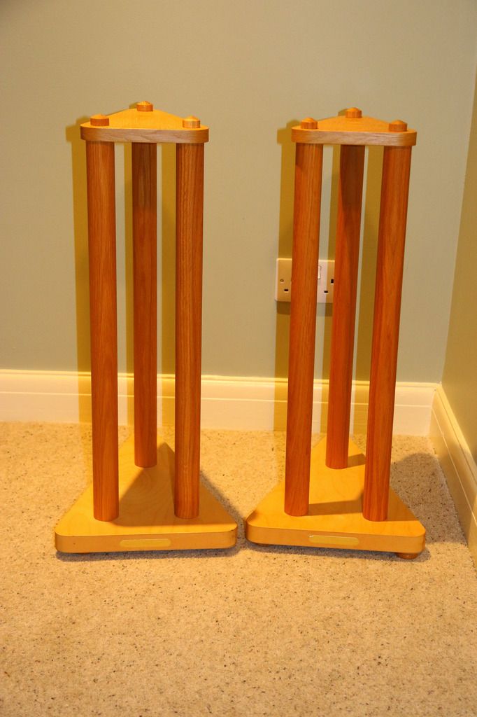

Simon, do you have any photos of wooden stands and info about wood that would go well with scm11. I could try and make my own.
Posted on: 10 July 2017 by Simon-in-Suffolk
I use these from Russ Andrews - but i place the ATC 19s directly on the top platform and don't use the Torlyte couplers
Mrs SinS like them as well which helps
Posted on: 10 July 2017 by Sun King
Beautiful
Do you think, something like this (with base plate) could also work?
