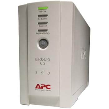

can I ask which APC you’re using?
kevin J Carden posted:can I ask which APC you’re using?

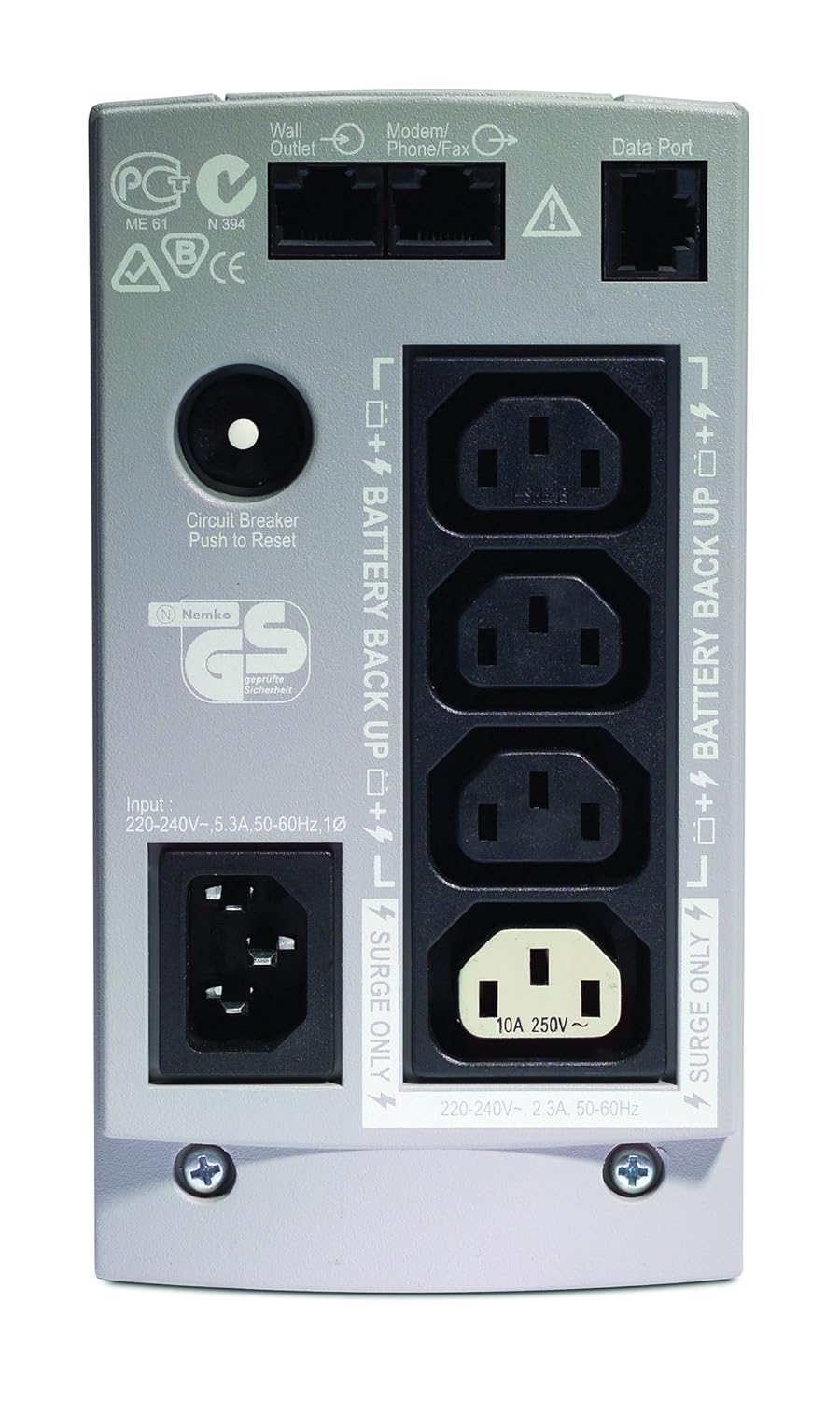

APC Back-UPS 350 350 gives a clue to the power (VA) it can handle, more than plenty for my NAS & two other SMPS's
Thanks again Mike. I will investigate. Having just splashed out c.£300 on a DrayTek Router I should also put that on the APC when I get it. Phone makes sense too.
