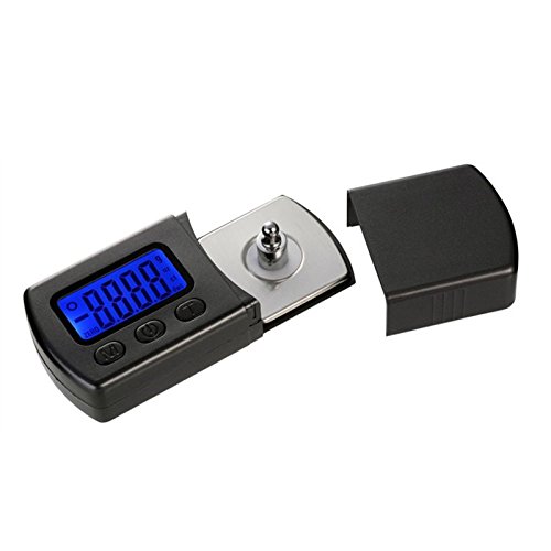

I use this electronic scale. At $7.00 delivered the price had me questioning its veracity. Then I found my TT dealer using the very same scale, saying he'd done calibration checks versus his reliable scales and found this one valid while more simple to use.
With a 5-g calibration weight. Easy to find on Ebay; search "new version stylus force scale"
The question for me is at what vertical height relative to the actual playing surface do you use the scale to measure the weight? You're measuring a long lever and it's sensitive. The thickness of the scale's measurement platform relative to the LP's surface should be taken into account. Should the scale be placed on the record mat? Should the record mat be removed? How "thick" is the scale? Point being, you should be measuring the stylus weight at the same level your LPs are being played. We're dealing with tenths or hundredths of grams. Then there's the horizontal aspect. Measure weight at the outer edge versus the matrix. Differences here could indicate TT leveling issues.

An interesting point from Joerand and one reason I like the old Technics so much.  It's designed to effectively measure at the same height as a typical LP and placement on the platter is a given too as there's a recess at the other end where you fit it over the spindle.

I use the exact same one
It's very sensitive and appears quite accurate when checking against my other scales ...but
I will only use it on a platform besides the turntable deck as it sites too high if I put it on the table ..even with the mat removed ..makes about 0.15gms difference on my aro ... which is very sensitive to hight when weighing
