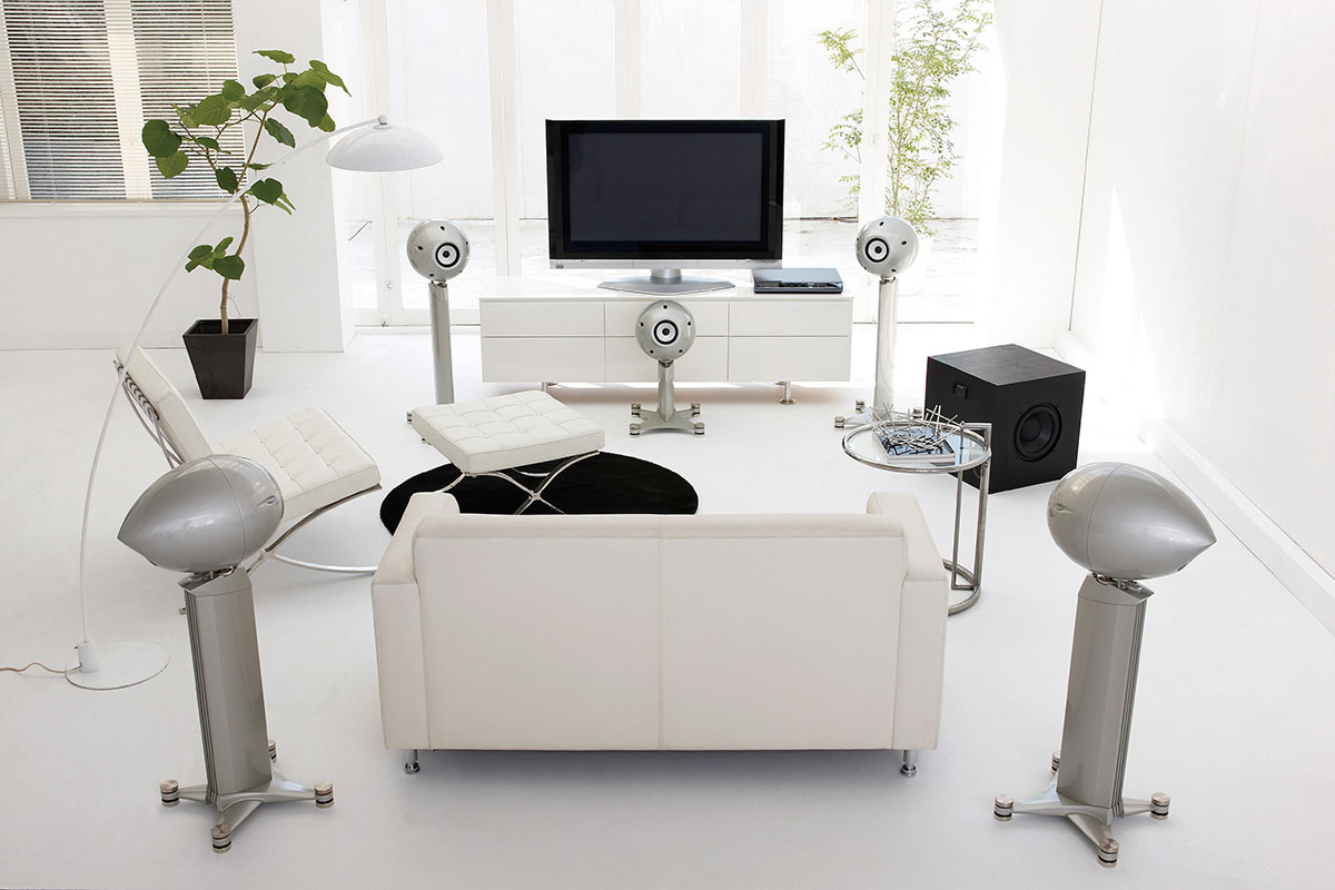

Have total sympathy - WAF's are very difficult to obtain.......my 'Hi Fi ' was banished to the study .......... and a white trendy home cinema system now resides in the lounge. This works for me I do allot of work in my study and thoroughly enjoy the music in the process..... so we are both happy...
White and trendy sounds like it's asking some of those Eclipse things. ![]()
Not that posh ...... Q acoustics 7000i ...... its ok (actually quite good) for films - poor for music....but importantly domestically unobtrusive.....agh..
