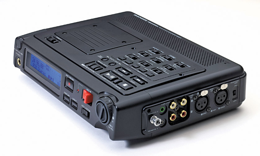

Another alternative is a stand alone digital recorder that records to a memory card and can then be edited on a computer.  Most are 24bit 96kHz capable and some, such as the superb Sony PCM-D100, will even do 24/192 and DSD.   If 24/96 is enough for you then the earlier Sony PCM-D50 and PCM-M10 are superb too, or else I can highly recommend the Marantz PMD661 and PMD671 - the last one in particular is a real favourite as it really can take the place of a tape recorder in a home system and has RCA inputs and outputs rather than the usual 3.5mm jack sockets.
