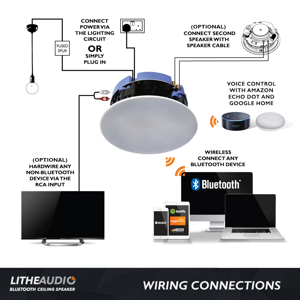

We’re having new bathrooms fitted in the coming months and are having flush in-ceiling Bluetooth speakers fitted from Lithe Audio (the grills attach with magnets once the speakers are screwed into a h9e in the ceiling).  These are purpose made bathroom speakers, are IP44 rated and will also have the matching fire hoods fitted.
Whilst not maybe as good SQ as in-ceiling Focal/KEF/B&W speakers, I liked the fact that the Bluetooth and amp are all built into the speaker unit and will be easy to maintain, should something go wrong.
We plan on having them switched via one of the light switches.  Also, we plan to have them paired with an Amazon Echo, so that when you want music (radio or from Synology NAS), we’ll simply be able to ask Alexa (there is an Echo ‘skill’ for Synology).  Each bathroom speaker will be given a different ID, e.g. en-suite or Family Bathroom, so that different music can be played in each bathroom.
Looking forward to it!
ATB. George.
