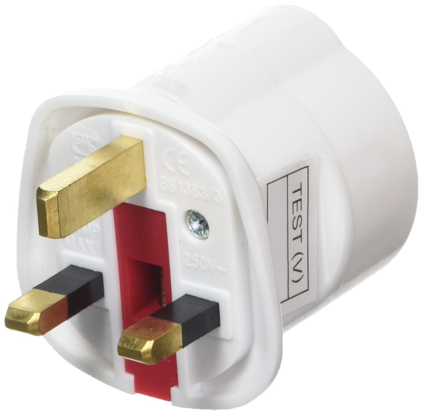

Trying to understand potential issues with using a UK 3 PIN adapter to convert either a Schuko or Australian plug.
Reason i found a power cable I REALLY like, the manufacturer makes a UK 3 PIN termination, but it is compromised in a few ways, so i was thinking of taking their standard Schuko or AUS termination then using an adapter (not ideal) but then it is also fused.
The power cable has 3 wires, for an AUS plug the wiring appears identical to the UK (Live/Neutral/Earth), whereas the Schuko on has two pins, so unsure what is done with the earth (or 3rd wire), plug my concern with the Schuko is ascertaining the Live and Neutral (aside from listening).
Posted on: 30 November 2018 by SamClaus
The Schuko has two small metal strips on either side of the plug : that's the earth.
Posted on: 30 November 2018 by Richard Dane
Avoid an adaptor.  Fit a good quality UK plug. Any adaptor will potentially be the biggest compromise here.

You could get a few schuko cables to power everything connected to a schuko distribution block, then connect that up with a uk 3 pin to your wall.
Posted on: 30 November 2018 by ChrisSU
One way in which a UK plug could be though of as compromised is the fact that it has to be fused. This is because of the different way in which UK mains circuits are designed compared to European and others. Using an adapter, such as those designed for travel use, would avoid the use of a fuse, and therefore would be potentially dangerous on a UK mains circuit. They are intended for low powered appliances, not permanently placed items such as big Naim PSUs.
ChrisSU posted:
I'm fairly sure that adaptors to allow use of non-UK plugs into UK sockets have to be fused, otherwise they would be potentially hazardous.

Posted on: 30 November 2018 by Mike-B
Depending we’re you are in the world it is possible to find adaptors that fit a non-fused Schuko or Aus or USA or AN Other plugs into UK 13A 3 pin sockets with or without fuses,  all dodgy, but the non-fused ones are hazardous as they do not comply to UUk BS safety standards
Best advice is avoid any & all adapters & fit the correct plug (Male) for your power supply.

Posted on: 01 December 2018 by ChrisSU
Richard Dane posted:
ChrisSU posted:
The adapters I’ve seen are unfused, and are labelled as for low power devices only. Without a fuse I’m not sure they are either safe or legal, but either way I wouldn’t run the HiFi through one.
Posted on: 02 December 2018 by Richard Dane
A UK adaptor that allows non-UK power plugs to be connected to a UK socket should always be fused.
It is not a legal requirement to have fused plugs in the UK... and BS546 (round pin) plugs which these days are almost always used for specialist applications don’t need to be fused for example ... and most are not..but these days are not usually found in a domestic setting... unless perhaps for high end lighting distribution circuits.
Therefore for personal safety and general common sense it makes sense to use a fused adapter in a general domestic setting, and significantly better still for non transient/ temporary  connections  replace the plug to match the local socket... oh yes replacing the plug and removing an adapter should sound better too (it reduces the mains impedance).
Interesting CE marks don’t apply to un tethered plugs and sockets.. so such a mark on a device is not really meaningful and might point point to it being fraudulently applied
Simon, round pin sockets are limited to being used on low amperage circuits though - essentially protected by the fuse or breaker at the fuse box, either 3-5A for small or 15A for large. Modern square edged three pin sockets can be fitted on circuits rated much higher, hence the need for a fuse to protect the flex.
As you say, always best to avoid an adaptor if possible and fit a proper suitable (fused in the UK) plug.

Posted on: 02 December 2018 by ChrisSU
Quite - a UK ring main, or a dedicated radial as per Naim's recommendation, might have a 32 amp MCB, or even higher, in which case I can't see how an unfused plug could be either safe, or compliant with UK regs.
